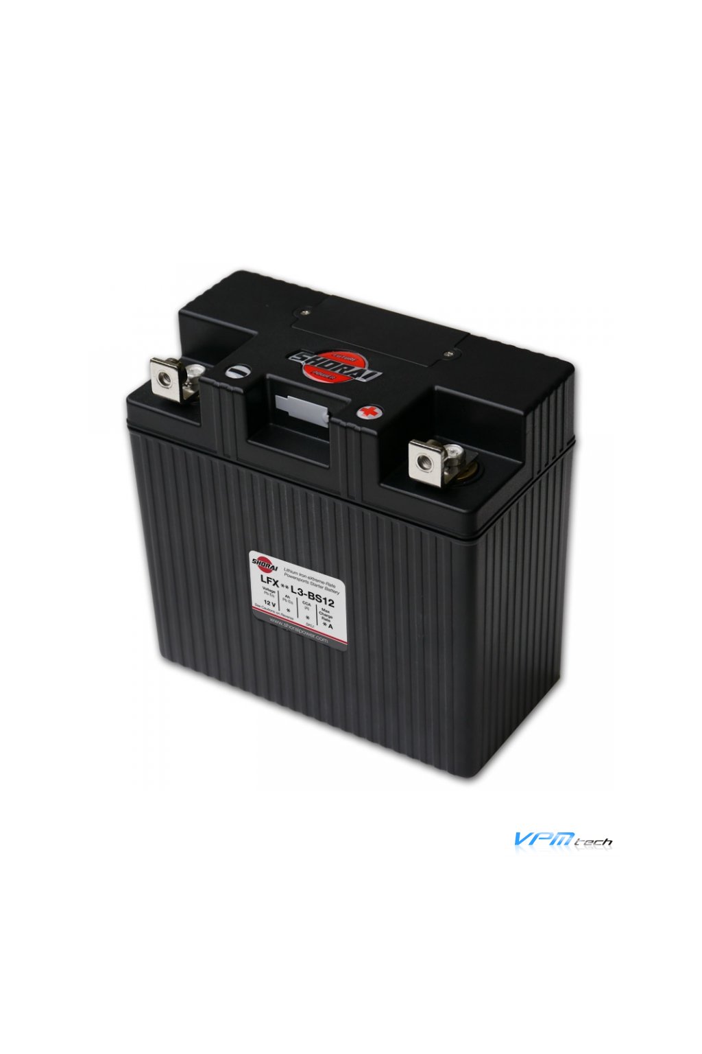

Need a battery for A Norden 901 and thinking about a lithium. Is it that much better and which brand are people liking.

I've had 4 shorai and 2 nocos. Never trickle charging is a godsend. Shorai's cost more, but I've had great customer support, needed due to user error (super deep discharge). I had to return one noco, but that process was fairly easy thru Amazon. I guess my overall opinion is: I'll never buy another lead acid battery.

 We run Battery Tender and Shoria brand lithium batteries in the rest of the Shed bikes...

Shoai are LiFePo4.
